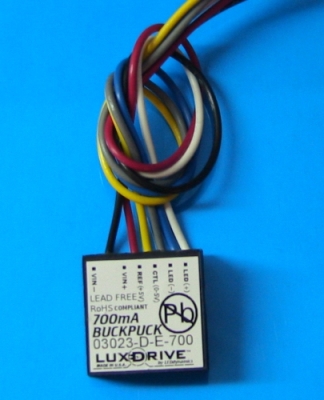

700mA BuckPuck LED driver.
These are used in place of a resistor and are much more efficient.
Min input voltage is 5v.
Max input voltage is 32v.
This 700mA version will provide the correct mA for Luxeon V LED's or any LED requiring 700mA.
The driver can easily power multiple LED's as long as you provide enough voltage.
IE.. you need around 7v for one Lux V, 14V for two Lux V, 21v for three etc..
The REF and CTL wire leads can be used to attach a linear taper potentiometer so that you can adjust the brightness.
