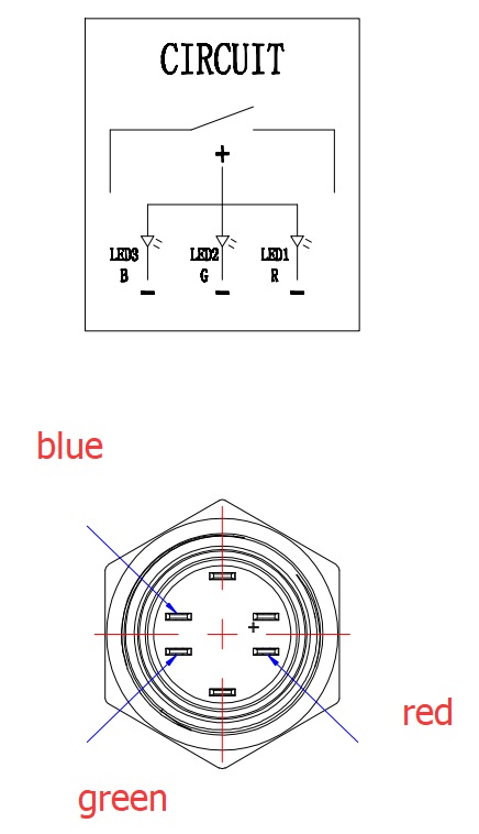

SPST Momentary Red-Green-Blue Illuminated switch with individually addressable LEDs.
Nickel plated body
Will work with all 16mm AV switch boxes. These will NOT work with the AVbezel as the shaft is not long enough to fit the nut on.
Red is 2.2v at 20mA
Green is 3.15v at 20mA
Blue is 3.0v at 20mA
Diagram
There is no internal resistor on these so you need to use the correct resistor in order to not fry the LED.

Fine for anything but CFX
Review by Matthew on 5/30/2020
These are common anode RGB switches but the CFX requires common cathode if using with a neopixel setup.
