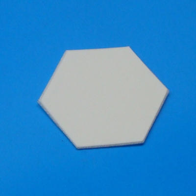

These pre-cut, thermally conductive, electrically isolating, pressure sensitive adhesive pads are precision cut to fit Luxeon I, III and V Star LEDs. Made from Bond-Ply® 100 pressure sensitive adhesive tape, these pre-cut pads makes it easy to fasten Star LEDs directly to a heat sink without the need for screws.
Features
•Excellent thermal impedance - 0.86°C-in2/W (@100 psi)
•Made from a high performance, thermally conductive, pressure sensitive acrylic adhesive tape
•Electrically isolates the LED from the heat sink
•Immediately bonds to the target surface
•Bond strength increases over time when repeatedly exposed to high continuous-use temperatures
•Pre-cut from Bond-Ply® 100 pressure sensitive tape, manufactured by the The Bergquist Company.
Benefits
•Provides an excellent dielectric barrier
•Can be used instead of heat cure or two part adhesives, mechanical fasteners or mounting clips
•Easy to use double-sided, pressure sensitive adhesive tape that bonds immediately
•High bond strength to a variety of surfaces
