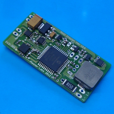

Petit Crouton Sound Module v2.0 with FOC and R.I.C.E support
There are two sound font choices, Light Meat and Dark Meat, which are stored on a SD card. One is included with the sound module and the other can be purchased separately if desired. You can add your own sound fonts to the SD cards as well.
If you would like to purchase additional sound fonts please visit SaberFont.com
Light Meat sounds
Dark Meat sounds
Owners Manual
Features & Maximum Ratings

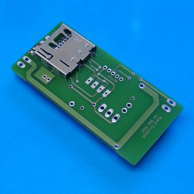

  • Dimensions: 1.9" x .93" x .3" (with the microSD card).
  • Power supply: 5.5 to 11 V / 2.5A (with the High-power LED). 2 li-ion cells (18650 or 14500) batteries recommended.
  • Idle current consumption : 3 mA (deep sleep mode)
  • 2A high-power LED driver
  • Speaker: 4 to 8 ohm.
  • Audio output Power : 2W
  • Accent LEDs: 2
  • 32 stages sequence with stop and loop instructions (using either 0 or 65535 for the delay)
  • Accent LEDs pad current source: 18 mA max per pad
  • Handles momentary or latching switch for on/off control
  • High end motion sensing technology
  • 100% compatibility with CF sound fonts, 8 clash, 8 swings, lockup, force sounds.
  • Blaster Blocking & Lockup Fx
  • Blade Flickering Fx
  • Blade Shimmering on Clash
  • Anti Power Off technology (A-POP™)
  • Foc™ Flash on Clash™
  • WAV file support
  • 12 bit sounds
  • Hum resume: defines if you come back to where the hum has been interrupted or not. Interesting for certain hums. Not sample accurate but resumes the hum in a ballpark of 11ms from where it's been interrupted by a fx sound.
  • Anti power off delay (offd) : variant of our Anti Power Off technology (APOP) use an adjustable delay when cycling the the activation switch.
  • Led current parameter now takes mA. To get 2A you would enter 2000, for 1.5A 1500 etc
  • Motion sensing thresholds now go up to 1023 (ls, hs, lc)
  • General sensitivity (i) is now an integer between 0 and 99. Same kind of value than on CFv5. Previously entered as float number (0.65) but is now 65.
  • Wiring is very similar to current CF, down to the accent LEDs location and FoC pad.
  • Shorter than PC 1.6
  • Mute on the go
